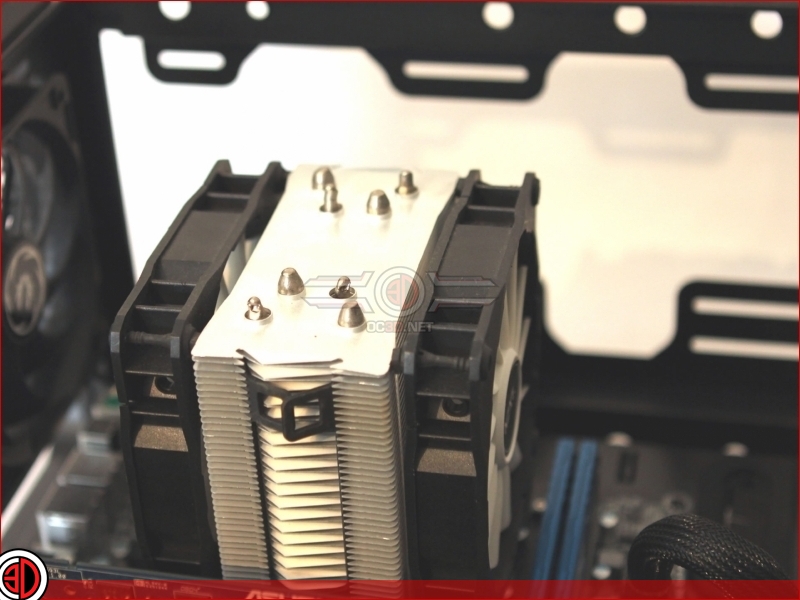

There’s 175mm of head room for CPU coolers so our Havik 120 has lots of room to breathe.

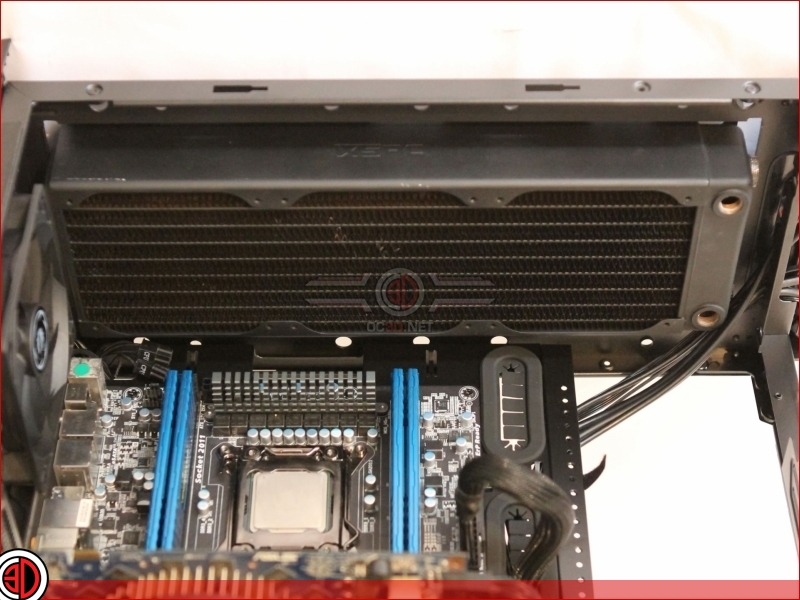

BitFenix only state compatibility for 240 and 280mm rads in the front, but as you can see, a 360 fits in just fine. Just in case you’re wondering, there’s a good 115mm of room from the mounts to the edge of the motherboard tray, and about another 20mm or so before you start to impinge on the cables, so with the primary fans outside of the mount, that means you can fit one huge fat rad in here in push pull with room to spare. The only thing to be wary of, is that you’ll be reducing that maximum 410mm GPU length.
The good news continues up in the roof, with there being mounts for both 360mm and 280mm radiators. As the roof is both recessed and off-set you also get a good 75mm of space to play with before you reach the motherboard edge. It’s possible to squeeze maybe another 10mm or so out of this if you need to, but you will then be running up against your RAM clips and Heat-sinks, so don’t say you haven’t been warned.
Certainly 75mm is enough for a set of standard fans and a 50mm thick rad so we can’t really see the need to try to squeeze anything much bigger in.
