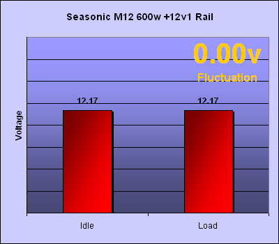

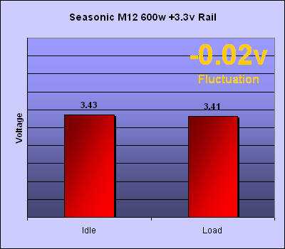

The tester will be placing the following loads on each of the M12’s rails:
+3.3v – 20a Load
+5.0v – 20a Load
+12v1 – 10a Load
+12v2 – 10a Load
+12v3 – 10a Load
+12v4 – 10a Load
The results are collected from a Mastech MAS-345 Multimeter which logs its readings via RS232 to a PC.

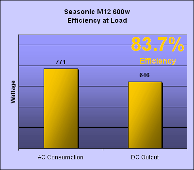

Efficiency Testing
Efficiency tests are performed by measuring the wattage consumed by the power supply at the mains against the power (in watts) consumed by the OC3D power supply stress tester. These results may not be 100% accurate, but have proven to be extremely close to results obtained from professional equipment.
